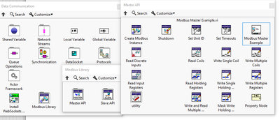

this is what it is displaying in palletes.
I installed the modbus library from the vi package manager and when i run the examples it directly showed the errors
Message 6 of 12
(1,706 Views)
What is "the modbus library" and what example are you trying to open ?
You seems to have installed multiple libraries for Modbus communication.

these are the examples i am trying to access...The picture of modbus library which i installed have also she it to you.Please let me know how do i fix the error

I can't open your vi's, and I have only installed the NI Modbus Library.
If you want to use that, it has its own examples:
I think the one you have problems with is the Plasmionique Modbus Master library.
You might need to contact Plasmionique to get help.
Also the DCAF Modbus Module requires DCAF as the framework. Might not work on its own.
