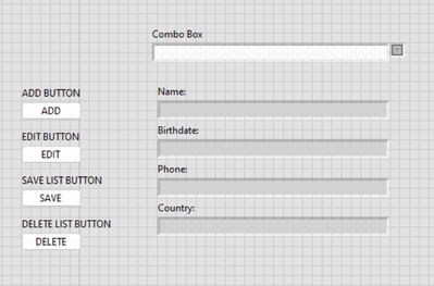

Hi everyone,
I am trying to develop an interface with a combobox, an add button, an edit button, a save button and a delete button. The names that I have in an excel list (first column) should appear in the combobox, and the other information should appear in the string Indicator (Birthdate, phone and country).
Example of excel list :          name          Birthdate          phone         Country
                                             George       xxxxxx              yyyyyyy      UK
                                             Rick            xxxxxx              yyyyyyy      USA
                                             Jhon           xxxxxx              yyyyyyy      USA
If I click on the add button, it gives me the option to add a new name, birthday, phone and country. If I click on save, the list in excel is updated with the new fields. But if I select a name in the combobox, and click the delete button, that line should be deleted.
So far I know how to display the information in the string indicators, but I don't know how to link the names with the combobox and the other functions that I mentioned. Can someone help me please?

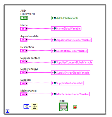

Thank you all for the responses.
I decided to use the Vi that ZYOng left me as a base, so I made modifications as you can see. I added a jump in the button add, so that instead of filling the data in the same VI, you can fill it in another VI.
The actual problem is, when i click on ADD button, the data is not saved on excel.
Can someone see an error in my code?
Message 6 of 13
(3,689 Views)

As you can see from the code, the add button just adds it to the data in the shift register. It gets saved to file once you press the stop button of the main loop. If you abort the VI, any data changes are irreversibly lost.
Even if you correctly stop the VI, you are not writing the header row, so the first data row will get clipped on the next read.
This is all extremely convoluted! I have a much simpler draft on another computer, so be patient. There is no need for globals and parallel loops!
