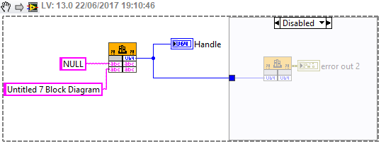

Im making a project that runs a executable using the windows command line. I have managed to open the command line from LabView and im able to run the executable correctly. The problem is that I want to close the command line automatically after a time when it opens. So Im trying to use "call library function node" with user32.dll library and FindWindow() and DestroyWindow() functions, because I think that I have to use this functions. Does someone know how to close the command line after a time? is it posible? am I using the correct functions?

On my system (64bit Win 10 Pro) the FindWindow is either FindWindowA or FindWindowW according to ANSI or Unicode. I think you'll have better luck with FindWindowA in LabVIEW, but I'm ready to be corrected.
You can pass it two constant C Str inputs and receive (for me) a U64 output. However, trying to close my Block Diagram window with the DestroyWindow(handle) function killed LabVIEW. It might be better if you actually own the window you're killing - the Microsoft documentation cautions that you can't destroy a window you didn't create.

Certainly:
I disabled the DestroyWindow(..) call. You can try with that - good luck šŸ˜‰
I sent "NULL" as the class type, this matches everything. "Untitled 7 Block Diagram" was the window I thought I could close, but it crashed LabVIEW when I enabled the DestroyWindow frame. Perhaps you'll just crash the executable you want to kill šŸ™‚

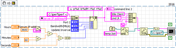

So I am guessing you want to close a window that is running a process before that process is completed.
Because you can set a boolean on the systemexec.vi to automatically close the window after the process exits.
What I have done in the past is use the taskkill command with the systemexec.vi
I have a program that builds a batch file line to launch Iperf in a console window and call the batch file with the systemexec.vi.
Yeah it's not pretty making a snippet messed it up a bit...
Anyway the part I want you to see is I set the window title of the Iperf window with the "title Client" line in the batch file. This is important as you will see below. Run the snippet and look at the created temp.bat
To kill the running Iperf I use the taskkill command, notice that taskkill need the window title of the task you are killing.
That says taskkill /FI "windowtitle eq Client*"
The only caveat I have ran into is taskkill can not kill a task that is ran as Administrator, seemingly even if my executable is ran as Administrator. I am guessing even if the LabVIEW executable is ran as Administrator, the systemexec is still running at lower privileges? So if someone has messed with Windows UAC (like I found on several machines on our lab) and set console windows to always run as Administrator, taskkill will fail.
He said that his program works with the command prompt. So he should write taskkill /FI "windowtitle eq Command*" /F
