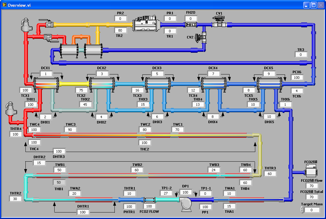

Let me give you an example:
I have this GUI with several controls and indicators.  If I used your method of using clusters to clean up the block diagram, would I still be able to have the front panel (GUI) look exactly the same way I have it as in the following picture?
Message 13 of 27
(1,899 Views)
Well of course!
This is the GUI of the code I showed previously.
I beleive it was Michael Aivaliotis  (one of the other LabVIEW Champions) on LAVA who once wrote something to the effect "Your GUI appearence does not neccesarily have anything to do with how your data is structured."*
Ben
* THis is not an exact quote. It is just my memory of what I recall.
Message Edited by Ben on 01-23-2008 01:23 PM

I think what everyone is mistaken is that Ben does not use clusters on it's frontpanel!
In the code he uses a cluster that contains references to all the controls, so he's passing them by ref.
This enables him to have a very customizable FP with clean code.
Ton
