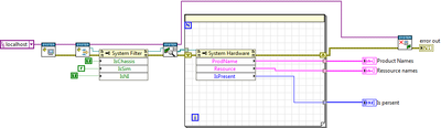

I am curently working with a NI PXIe-1078  chassis connected to my computer through a MXI link.
I need to check if my chassis is correctly power up and connected to my computer.
I tried to use the System configuration API as shown below, but even when my chassis is not connected, I get a connected status.
If you can help on this subject....

Hi Bob,
Unfortunately, I have the same problem in MAX : my chassis is declared as connected, but there is an icon on my chassis with a white cross in a red circle.
So I guess that MAX knows that my chassis is not in-line, even if the chassis is declared as Connected.
