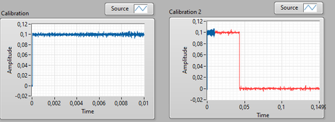

I need some help with a scientific problem : I have to acquire a voltage with a USB 6361 with a frequency for 2MHz. However, the acquisition is rather long, during at least two minutes. I have to keep a high frequency for the first tens of milliseconds to observe the transient, but I want then to reduce the frequency in order to have not too many points in my file. For example, I would 2MHz for 10ms, then 1kHz for the rest of the acquisition
I have built a state machine for my project where i tried two solutions :
1) The first one is called "calibration" : I have created 2 state (Calibration and Calibration 2) and each one has DAQmx modules to read the voltage. After completing the first acquisition, the second one begins.
The problem with this solution is when I try to measure a signal, for example a pulse of 100ms, some data is lost between the two states, as you can see in the picture below.
2) I have tried to do everything in one state : i tried to change the frequency of the measurement right after the end of the first step and to continue with the same task. The first step of measure works but not the second, I have a timeout error. The state of this method is called 'Test'.

10ms at 2MS/s gives 20kSamples…
  • So set up a continuous AI task to read at 2MS/s
  • read blocks of 20k samples, resulting in 10ms blocks
  • save the first block completely, with all samples to file
  • save the following blocks only after decimation, by reducing the number of samples from 20k to 10 (by a factor of 2000), resulting in an effective samplesrate of 1kS/s…

Ok I think we are almost there and you have been a great help thank you very much. The only thing that remains is the fact that the decimated part doesnt have the right time stamp : as you can see in the picture, you have the stap that last 10ms (as expected), but the value after the step should not represent fews ms but more like second. Do you have an idea of how to give the right time stamp to these values ?

Save the first iteration to group1 and the following iterations to group2. Now the waveform properties can differ as they are in different groups…
(And correct the waveform dt in case the decimation function doesn't adjust it on its own.)
