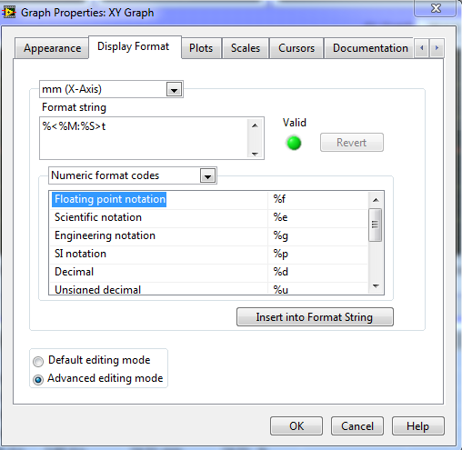

In my project The user need to see the Graph that display (force-distance) or (force-time(relative time))
 i'm using build XY Graph.
as i see here i change the display format .
Create»Property Node»X Scale»Display Format»Format
 and set the Display format like this :
and The graph is exactly what i need.
but when i change format to number "0" for Decimal value(to displaying distance ) and then back to relative time
it's not longer in relative time display format (befor reached 1 minute )
how can i set the display format property in program ?

I've just found :
(3,480 Views)
Yes, that would be the way to do it.
