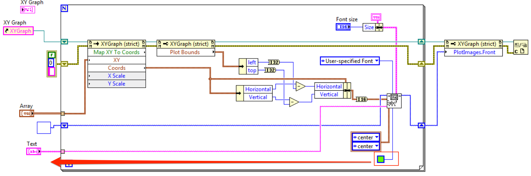

Hi p2kmafia,
Probably you just forgot to put the picture in a shift register. Below and attached a modified workaround for many annotations. Hope that it will help you achieve what you need.

how to put different colour for different text
Message 7 of 12
(11,533 Views)
 Well in the VI above you see the green colour box at the bottom right of teh for loop?
Move it outside of the for loop as shown below, place it in an array and you need to have the same amout of items in this array as there are in the string array.
The "colour array" has to index at the loop border just like the string array does.
