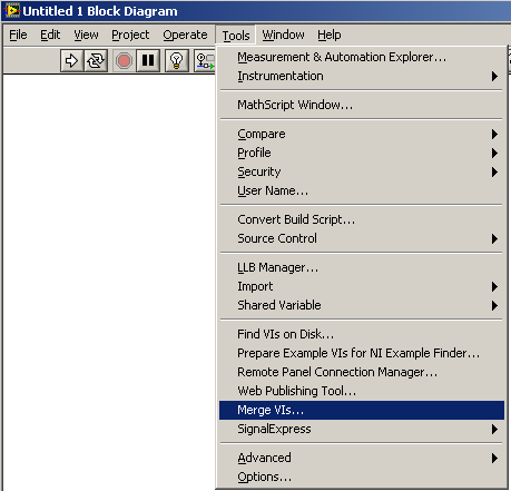

I just installed Laview 8.5. I want to use the merge tool but can't find it anywhere. Everywhere it says it is under Tools Menu but I can't see it. Can anybody help me with that? I can find the LVMerge.exe for use with SCCS.

It is under the Tools menu as shown in the attached image.
Which type of package do you have?  Base, Full, Professional, Developer Suite?  I'll check if it's with all versions...

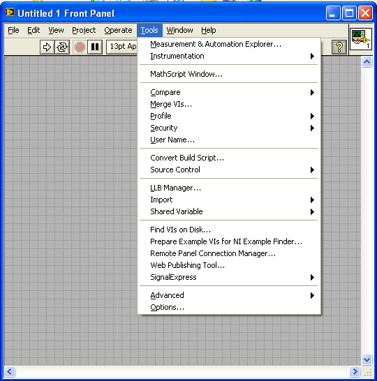

        Thanks for looking around. I have installed Labview from the Full Development Suite but not sure whether that really matters. I have attached a screen shot of tools here. It is different than yours.

Here's my Tools menu which is a liitle different than Joe's but the Merge VIs is there. I notice that you also don't have the Compare option. I know that this is only available with the pro version of LabVIEW so maybe the Merge is only part of that package as well.

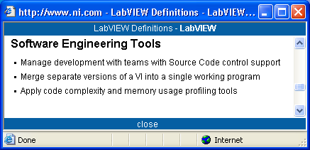

If you go here and click on the 'software Engineering Tools" that is listed as being available only for the pro version, you get what is show below.
Message Edited by Dennis Knutson on 02-20-2008 07:32 AM
Message 7 of 8
(3,502 Views)
Hi Dennis,
Thank you!  It's clear now!
BJK
