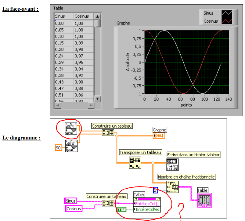

I need to create the following diagram, but i cant find some functions in the palette...
For the sinusoidal signal, I've searched in the palette but I don't find it.
For the one in the bottom, it is a property node of the "table" that sets the header for columns, but i don't know how to select only those properties.

Haven't found the first function (what Version of LabVIEW are you using?), but the second Table properties can be found as follows:
  1. Right-click the Table Control and choose "Create", "Property Node" (en Français).
  2. Look at the bottom of the list for (in English) "Column Header Strings.
  3. For the second one, "pull down" the Property you just created (to create the second box to hold a new Property), click inside it, and look near the bottom of the list for "Visible Item", and choose "Column Headers Visible".

That first function looks like a very, very old version of Sine Pattern.
It's now under Signal Processing>Signal Generation. Or use quick drop of course.
Yup, that was the icon of Sine Pattern.vi in LabVIEW 7.1 and previous.
