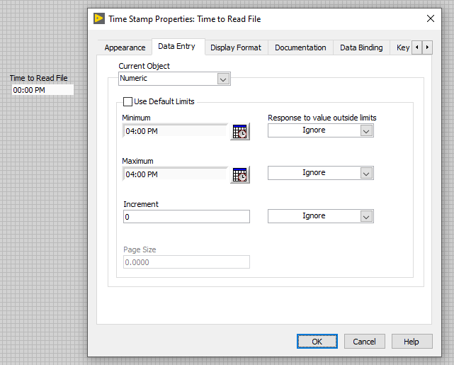

This happened to me all of a sudden.  I am not able to enter a time in a numeric control.  see attached.
When I enter a time it just defaults back to 0
Any help would be appreciated

You have some weird data entry limits set (Max=Min). Does it work better if you go back to defaults?

I deleted my control and created a new one and that fixed the problem.  Weird...
I can't enter 7 for the hours if the minutes are 0 though.  I tried setting the data entry limits to default and still the weird behavior.

Remember that the time stamp control is not just for time, but for time/date.  So even though you might enter something like 3:00 pm,  that is 3:00 pm on a particular date that is not shown with your display settings.  If I show the date and enter 3:00pm it is 3 pm on 12/31/1903.
Which time zone are you in?  Are you eastern?  I found the same issue.  And 7 pm would be a special time/date in the eastern timezone because 7pm 12/31/1903 is time 0 which is midnight UTC for 1/1/1904, the epoch of the LabVIEW time system.
I also think I remember some issues, (bugs?) in LabVIEW related to entering some times at the epoch.
Remember, you can also set a double numeric control or indicator to display a value in the format of time.  I think that may be a better way to handle a time that you don't want to have a date associated with it like here where "Time to Read" file means, hey I want to read it 7pm every day.  You've got to do the code to handle it, but you've got to deal with it also with a timestamp control to distinguish between 7pm yesterday, 7 pm today, 7 pm tomorrow, and 7pm on 12/31/1903.
EDIT:  I did a little searching to see if I could find a thread that I think exists suggesting a bug.  Haven't found that, but found this https://stackoverflow.com/questions/15106210/incorrect-timestamp-control-value which talks about the special case of 0 for a timestamp.  Basically a hard 0 is a special time that LabVIEW displays like an empty timestamp display rather than the data that is associated with 0, the epoch of midnight 1/1/1904 GMT.
