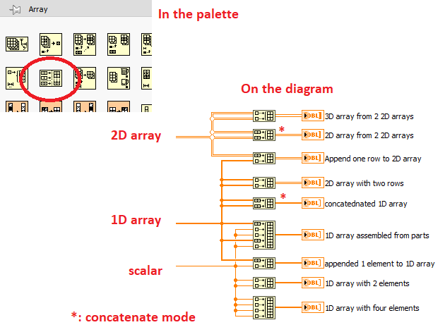

Can someone help me find this???
Hey people, I am trying to recreate an Array function but got stuck in this tool. Thanks in advance who are spending their time.

That is the "build array" block.
The feedback node is passing the output array back into the build array function of every iteration of the loop.
Essentially every new value of "PV" is being added to the end of the existing array of PV values.

Many functions dynamically change their appearance depending on what's wired to it, including the "build array" node you circled. Your question seems to be specifically about that, so I won't talk about things that have not been asked.
Here are a few examples how it changes its look based on what is wired to it. (All inputs can differ only by maximally one dimension order and mismatched sizes will be padded to the largest input with zeroes as needed)
Since you only show a truncated diagram I will refrain from commenting on the sanity (or insanity) of the rest of the code, we can't even see the initializer terminal of the feedback node! If you want help to cleanup the rest, please attach your entire VI and explain what it is supposed to do.
