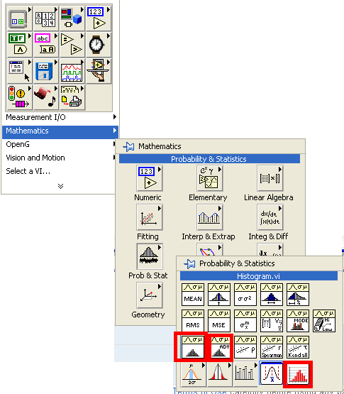

Can labview display a histogram plot of data?
I want to know how I can display a histogram of data?
Message 1 of 19
(29,090 Views)
There are at least 3 histogram vi's.  Outlined in red below
Message Edited by elset191 on 08-24-2009 04:03 PM
Tim Elsey
Certified LabVIEW Architect
Message 2 of 19
(29,088 Views)
If you already have histogram data (and it seems you do!), just use a waveform graph with one of the bar plot styles. Make sure to adjust x0 and dx. so the x-axis is correct.
If you need to calculate the histogram first, use Tim's suggestion.
Maybe you should attach a small VI containing typical data so we can better see what you need to do.
Message Edited by altenbach on 08-24-2009 02:25 PM
