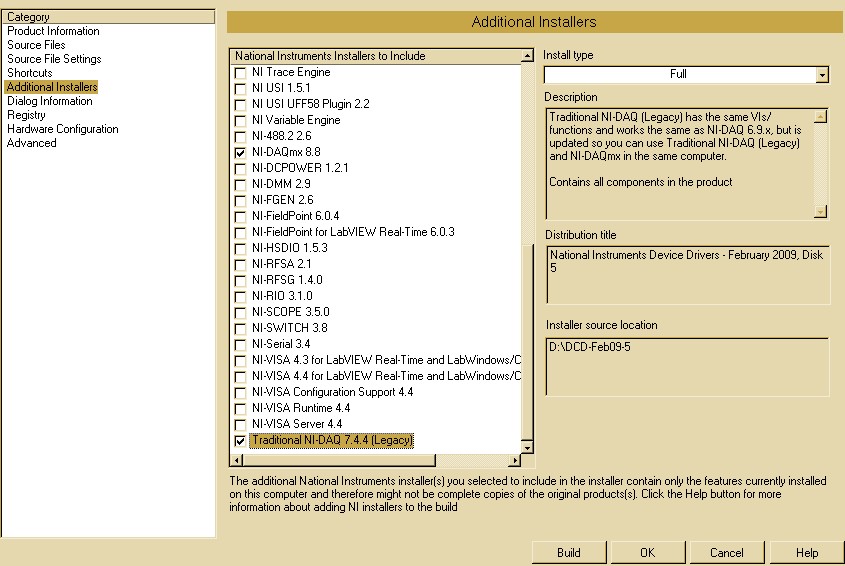

I connected a NI USB-9219 4 channel universal analog input module, your standard 4-20mA, and a DAQ assistant in the vi attached.
However that day due to some reason (solved now) I could not build a installer file with NI-DAQmx8.8 additional installer as below:
Thus because the setup file was required urgently I used the instead the traditional N1-DAQ7.4.4 instead to replace the N1-DAQmx8.8, and successfully build the installer file
Now I dont have a N1 USB 9219 to test if my installer file (with the N1-DAQ 7.4.4 binded and no N1-DAQmx8.8 binded) works or not, so my questions will the N1-DAQ7.4.4 works with the DAQ assistant in the vi attached as well as N1 USB 9219?

Traditional DAQ and DAQmx are two different APIs which means that you cannot expect the DAQ assistant to work with Traditional DAQ. You will need to figure out why the installer is not being compiled with DAQmx.

No, 9219 only supports by DAQmx.
You cannot use traditional DAQ with 9219.
But since you claim that the problem is solved, thing should be fine for you now, but if it's not, please explain the problem in detail so that we can see what we can do.
If the problem comes from including DAQmx with an installer, install DAQmx on remote machine separately will help also.
