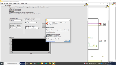

First of all, thanks for your reply. I ran the code as earlier, and it was giving an error for a counter for the sample clock "Retrigger able counter", for which when I selected Dev1/freqout then, I did not get the same error. After that, I got this error, and again, I got the same error.
Kind regards
Hasham

Accepted by topic author Hasham622x
Ok, my mistake on the first part.  I used MAX to create a simulated 6255 and found where I went wrong.  The trigger source for the counter task should be "/Dev1/AnalogComparisonEvent" rather than what I previously typed out long-hand ("/Dev1/ai/AnalogComparisonEvent").
The drop-down selection on the front panel could probably have steered you toward the correct syntax.  Take a little time to explore the options for future reference, especially when right-click for I/O Name Filtering and include Advanced Channels.  It's sometimes also handy to check the Limit To Device box.
-Kevin P
