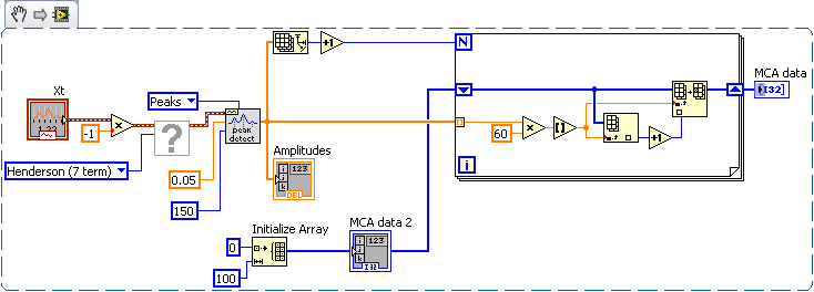

My application is such that I am continuously acquire data form an oscilloscope, process it and show it on graph. oscilloscope is continuously writing data into an array. This array data I have to use in a processing block. I am seeing that data is not passed from this array to the processing block. What I conclude that we can not simultaneously read and write into an array. If this the problem then how to fix this problem. I mean continuously acquiring and processing the data.

If you have two parallel tasks running, one for reading the data and one for processing, I would recommend that you do not use the same array for both tasks. You should use a queue to pass the data from your acquisition task to the processing task. Using the same array will lead to race conditions unless you put code around it to protect against that. However the native queue already has that protection not to mention you will be working on two distinct sets of data.

thanx for response but taht too is not helping. I am attaching VI. you can see that peak detector's output is fed to the processing block inside the for loop. When I am using this VI in signal express, "MCA data" array is not getting updated. I am able to see the data upto "Amplitude" array but not beyond that. Also in signal express MCA data is not being shown as an output node, while I have connected it to the connector pane.

Hi number,
you missed the complete concept of dataflow... Please go through the free online courses on NI's website!
Ever heard about shift-registers? Race conditions? Using auto-indexing? As it doesn't seem so: RTFM!
Why do you use auto-indexing in the for-loop and wire the count input too? Why do you wire N+1 to the count input when your input array only has N elements?

changed VI just a little bit...

Here you go...

Accepted by topic author Vipin_Saklani
Many many congrats to "Proven Enthusiastic "
finally got the problem solved.
