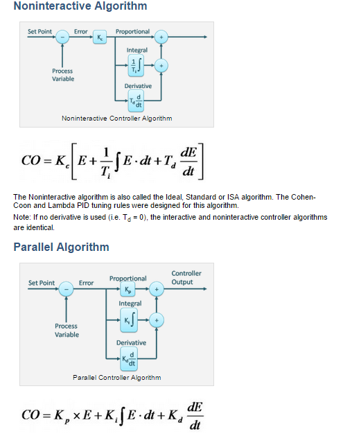

The PID Advanced VI uses the "noninteractive" algorithm seen in the picture below. This algorithm does not have individual Kp, Ki, and Kd gains; rather, the algorithm uses a controller gain, Kc, and integral and derivative periods, Ti and Td respectively, to control a process (which, according to the pic's site, is more intuitive and commonly used in industry).
http://blog.opticontrols.com/archives/124
However, this means that I can only create a P, PI, PD, or PID controller. I want to fiddle with a D controller. Can I do that with the PID or PID Advanced VIs? If so, how?

Found it! PID Structure Conversion VI
But a lone Ki or Kd term still won't affect my PID Advanced vi's output (with Ki and Kd ranging from 5E-7 to 5E7). Am I wiring the PID Advanced VI incorrectly?
