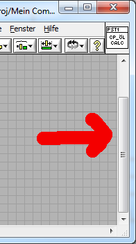

Hi behzad,
I marked the scrollbar with a red arrow:
