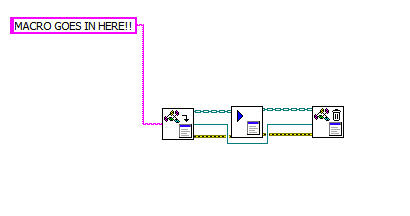

I have precisely the same problem. I want to rotate the Y axis 90º in a graph made with the report generation toolkit in word. Anyone know how to do this?

I think he means he can modify it by hand after the report has been generated... But what I want to do is generate the word graph out of labview already with the rotated axis label...
After I posted this I found out that we can do this with a macro and use it from labview, but unfortunately I don't know VB, or VBA... 😞
Like this:
