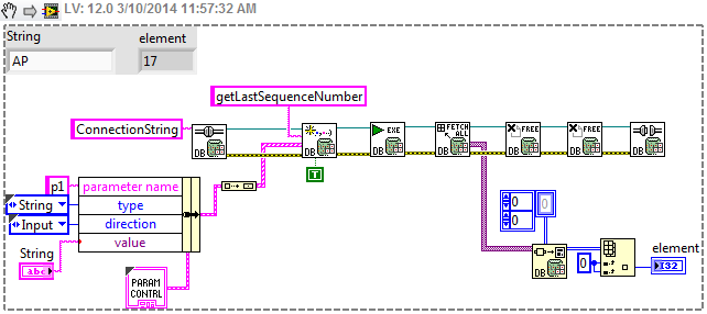

I created a stored procedure on my machine just like yours using my own table.  Using the code below I got a value of 17 (verified in SSMS),  Did you modify the Create Parameterized Query VI as I originally stated in my first post?
 CREATE PROCEDURE getLastSequenceNumber
    -- Add the parameters for the stored procedure here
    @p1 nvarchar(10) = ''
AS
BEGIN
    -- SET NOCOUNT ON added to prevent extra result sets from
    -- interfering with SELECT statements.
    SET NOCOUNT ON;
    -- Insert statements for procedure here
    SELECT max(pk_tporlog) from tporlog where cuserid = @p1;
END
GO

I did not modify the Create Parameterized Query VI.  I just did and now it works!  Thanks so much for all the time and effort you put in to helping me, it is much appreciated and was a huge help.
