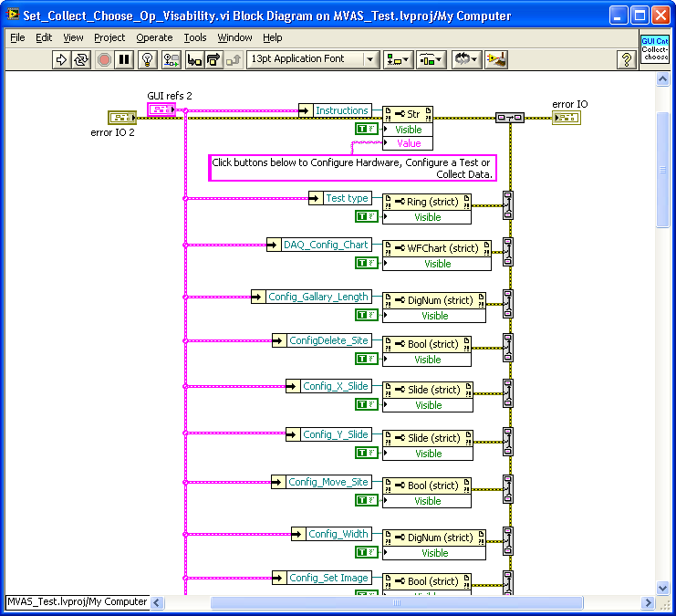

Yes based on only the description we have to resort to filling in the blank with our own images. In my case I have developed code along the lines of what I have in My GUI Gallery found here that features images like this...
I adapt my code style as authors adapt the writing to their audiance. In the case of the code shown above, my "readers" were graduates of LV 1 & 2 and they have been able to quickly navigate and maintain the code themselves.
More advanced "readers" my have recieved code that used sub-panels to keep things cleaner but that would have required more interaction between the instaciated sub-panels which may have put the code beyond their "reading level".

Thanks for the response Ben. I wish I could show a screenshot of the code, but I can't. However, in your third image, that I kind of what I have, but all the references go into a array builder, and the next frame searches for the references based on the screen the user chooses to see.
So, it looks like i can put those references into a subVI, and just output the array to the next frame in the sequences to help decease space.

If you are going to take the time to fix the code, let me offer some more suggestions that may make your code easier to work with, develop and maintain.
1) Use Typed-defined clusters to pack-up and access the control references.
2) Look at the mini-nugget here to learn how easily create the clusters.
Note: type defined cluster let you keep all of the controls ref in a form that you can esily sort through to find the refernce that you need. Using clusters also let you preserve the reference so that you can get at more than just the generic properties without having to explicitly cas tthe reference when it come stime to use the property/invoke nodes. If the control type changes you pdate the type def and you do not have to sort thhrough all of the code to find the palces it is use.
3) Concider using an Action Engine to both share or act on the referenced controls as a group. Operation like "set config mode" can disable all of the non-config controls in a single AE call. That will keep your code cleaner, and let you quickly find the place where adjustments are required. Example: Customer say "we need to enable this when we disable that".
