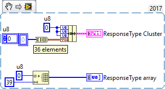

The AASiMbResponseType struct you have to pass by reference. It has a fixed size array in it, again. You can emulate that using a fixed size cluster or replace the entire cluster with one u8 array.
Either construct the cluster manually or using the Array to cluster node. In this case, it is easier to just pass a 39-element byte array instead of a cluster.

many thanks for your reply! I tried to call the function in that way. Looks very nice 🙂
Unfortunately LV still crashes. I think there still some kind of memory leak!

I would try making the request and response both the 39 byte array types. I have done this for value and reference struct types and did not break it up into multiple parameters, did all the binary formatting on the LabVIEW side.

The principle is ok, but you are treating each char as an inidividual parameter. A structure in C is however flattened in memory. That means that a parameter can contain 4 bytes in 32-bit LabVIEW and 8 bytes in 64-bit LabVIEW.
Your structure therefore needs to be converted into a number of 32-bit or 64-bit values that are then passed as individual parameters to the function.
So for 32-bit LabVIEW you end up with 36 + 3 bytes distributed over 10 32-bit integers and in 64-bit LabVIEW it will be in 5 64-bit values. To make matters even more interesting, you have to account for endianess and possible alignment. So the DatLen goes into the LSB of the first 32-bit parameter. Then follows the Opcode and Circuit. Since the Data is byte sized, I'm fairly positive that it directly follows the 3 first bytes, so the Data[0] element would end up in the MSB of the first 32-bit parameter. But I'm not 100% positive about this, so you may have to experiment. Then continue for the remainder of the Data in the same way, filling up unused elements with 0.
ExpResLen would seem to be a shortcut for "expected response len" so might indicate the length of the last parameter but if you are positive that -1 works too, then why not.
The 39 bytes for the last parameter should be ok, but I would generally round it always up to the next multiple of 32-bit or 64-bit, so in this case 40. That's what most modern compilers nowadays do as well. It should not crash as the DLL has no business trying to access that last filler byte, but I had situations where it did for some reason and actually crashed.
And as cordm mentions, the Win64 bit calling convention specifies that parameters that do not fit in a 64-bit register are always passed by reference, even if the C code specifies by value. So there you would pass the request parameter just as you do the response parameter, as an array pointer of 39/40 bytes. Or you could create a cluster with the 3 initial values followed by a second cluster with 36 U8 and pass it as Adapt to Type. But for 32-bit you have to do the "flatten into 32-bit values" to pass individually for the first structure.

After implementing the latest hints from @rolfk everything works! The -1 for the response length was defined by the DLL-developer for "unknown".
