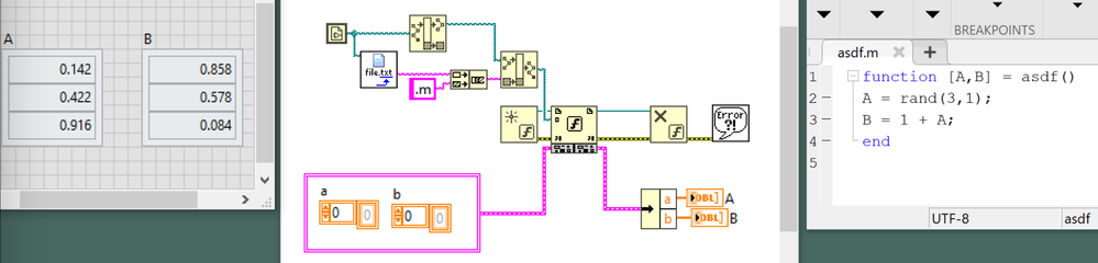

I was keen to try the new Call MATLAB Function node in LabVIEW 2021 and learned that if you make changes to the m-file, you must kill the MATLAB process before running the VI again.
For example, put the attached VI and M-file in the same directory and run the VI.  We can see that B = 1 - A.  Screen Shot 2021-08-23 at 00.42.10.png
Change line 3 of the M-file to B = 1 + A, and we still get
But if we kill the MATLAB process
and re-run the VI, we now have the expected behavior of B = 1 + A.
Is this the intended behavior?  Either way I'm posting here so others know what to expect.   

I just checked - closing the VI doesn't change this behavior.
Quitting LabVIEW, however, has the same effect as killing the MATLAB process.
(7,464 Views)
Accepted by topic author resono-mp3
It's a known issue, see https://www.ni.com/en/support/documentation/bugs/21/labview-2021-known-issues.html
It claims it's resolved in LabVIEW 2022. Not sure what to make of that...
