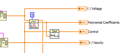

I have issues using the polynomial curve fit function. I have an array of velocities (x axis) and an array of voltages (y axis). I want to do a polynomial curve fit and get the coefficients for the calculations of the voltage into velocity. I gain the data during a calibration and need to use it separately afterwards. I wired the Vi as I see correct, when I use the calculation backwards, it calculates wrong values for the velocity.
In equation, I want the coefficient for:
Velocity = A + B*Voltage + C*Voltage^2+... (Fourth order)
I hope I could somehow explain the problem. I don't see my mistake here so any help is appreciated. Thanks in advance, the Vi is attached.

You need to read the help. You polynomial evaluation requires the best fit coefficients and [X] and does not need any FOR loop. (You hooked it up to the best fit instead of [x])
Try as follows. Works just fine!

Hi altenbach,
thanks for you advice.
Helped me find the solution!
