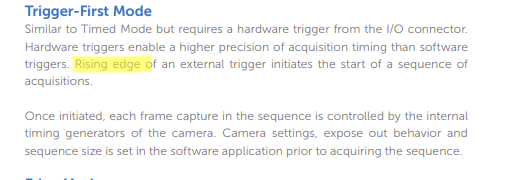

My question now is about the wiring of the camera to the NI device and the commands in matlab. We connected 3 BCN cables to the camera ('Trigger in', 'Read Out', 'Expose Out 1'). We want to trigger the start of the camera with the 'Trigger In' cable. The cable descriptions can be find here at page 20.

My overall goal is to start the intracellular recordings and the camera at the same time. Thus, the camera needs a start trigger which initiates frame acquisition. I believe I need a hardware trigger from the I/O connector. The trigger just initiates the start of a sequence of acquisitions. Then each frame is controlled by the internal timing generators of the camera.
I assume the 'Trigger In' cable should initiate frame acquisition. 'Read Out' and 'Expose Out 1' should just be an output.
