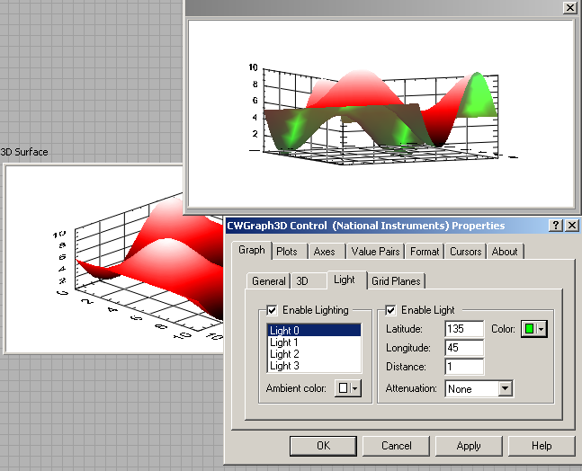

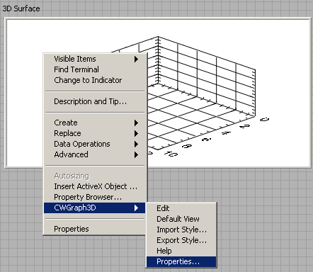

I use CWGraph3D component. For my application i must manipulate with the light parameters. The problem is, that is not possible to find the manuals for CWGraph3D, special for lights parameters like longitude, altitude and distance (what is efect and range of parameters). It is possible to put the lights under the 3D graph? How?

One other thing: if you need to programmatically control the lights, it's straightforward to do using the CWGraph3D class property Lights.  There are four lights in that collection, so use the Item method to return one of the lights and then you can change those properties (see attached example).

Thanks for a helps. But i still not understand different ligths parameters like longitude, latitude and distance. Where is position of the ligths relativ to xyz axis?
(3,910 Views)
Well, I'm far from an expert on lighting, but when I started to play with the lighting I did what the modern person would do: turn to Google.  I found a couple of useful tutorials here and here.  Aside from that, enable just one light and change the latitude or longitude of the light source.  You should be able to see the shadows change relative to "where the light is."  Think of it as the origin of the coordinate system being the center of the earth, and you'r moving the light along the latitude and longitude lines.
The distance is just how far the the light is from the center (in the units of the graph).   If you have attenuation, then the farther objects are from the light, the dimmer they appear.

RGreg wrote "...but when I started to play with the lighting ..."
That's the ticket!
If you really want to understand the operation of the 3d graph, you should "play with it" yourself.
