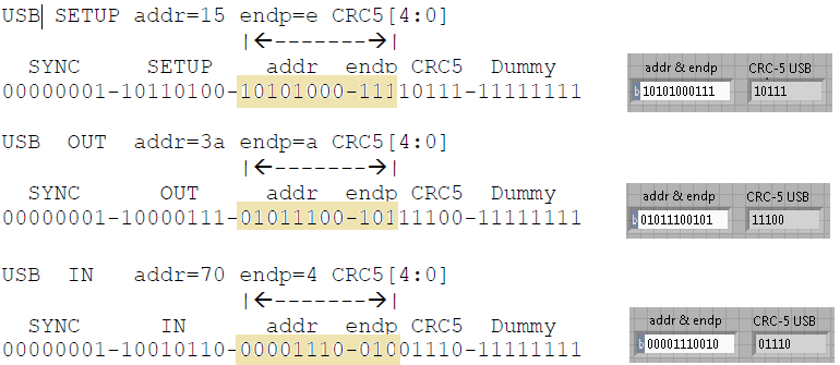

@malkowki wrote:
Thanks Mathew_Kelton! it works fine.
There are so many different variations of the CRC algorithms. Each equipment/communication standard has their own spin on how to implement it. It wasn't stated by the OP how the CRC5 USB was being used. From what I assumed and from the VB code, it appeared to be very close to the USB spec.
I'm not an expert, but looking at a white paper from usb.org (here) , and also here, the CRC5 is used in Token Packets for the 11 bits: addr & endp. The 5 bit CRC aligns the 11 bits to a byte boundary. Here are a few examples of a USB Token and my CRC5 calculated results.
Matthew_Kelton's algorithm seem to work fine for the OP (8-bit data), but I couldn't get the addr&endp CRCs using that code and the settings he provided. I assume his code zero pads the bits to get an entire byte boundary?? Am I doing something wrong? Or does it need different settings?
I only mention this because someone may do a search on using the CRC5 USB for Token Packets per the USB standard and get sent here.
