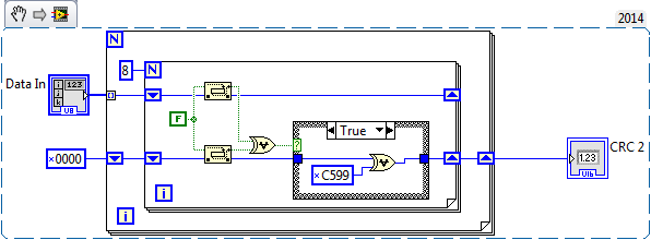

I am desperately trying to calculate the CRC with the polynomial P(x) = x15+ x14+ x10+ x8+ x7+ x4+ x3+ x0  (0xC599), to recreate the CRC of a transmitted CAN Message. I have searched everything and everywhere I think and I can't get it to work. I have a couple of CRC-16 vi's who work fine for CRC-16-CCITT and CRC-16-IBM. My problem is when I change the polynomial to C599 I don't get the right CRC.
The Input Data is: 800100
Output CRC should be: 4B5A
I checked with the online tool http://ghsi.de/CRC/index.php?Polynom=1100010110011001&Message=800100 and on my oscilloscope.
If there is any help out there I would gladly appreciate it.

01 - 4599
02 - 4EAB
01 66 - 7AA9
