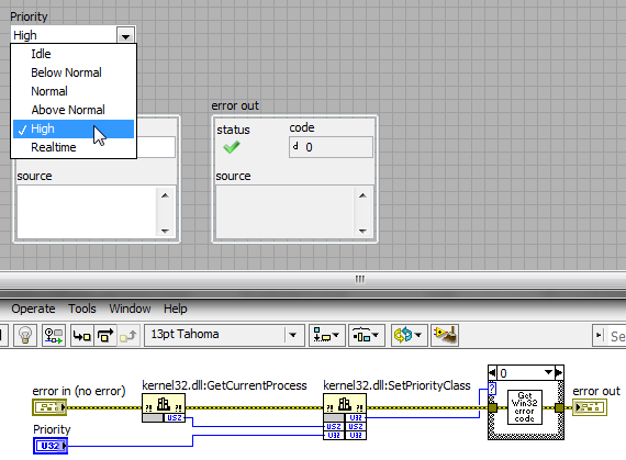

Hi Troy,
I'm using your great VXLPI, It's excellent. But could you send the periodic message every 20ms +- 2ms in Labview? The windows can guarantee that precise timing?
Hamid
Message 6 of 15
(5,886 Views)
No it can't guarantee any kind of timing.  Have you ever been using your computer and your mouse or keyboard just stops responding, and windows goes Not Responsive for 20 or 30 seconds?  What do you think will happen in those 2ms window you have for sending a message during that time?  If your setup truly requires a rate of 20ms +/- 2ms, then you are going to need hardware timed transmission such as the XNet hardware, or some deterministic OS on reliable hardware (like an embedded cDAQ, cRIO, or other microcontroller).  But honestly in most cases your timing needs aren't as tight as 2ms.  CAN is a network that has lost frames all the time, and it is expected.  Higher priority messages will cause lower priority ones to have to be resent.  With all this in mind most devices that want to see a message every 20ms, usually have a much higher timeout like 100ms or more before it will think a device is no longer transmitting data.
If I can call a VI by PC timer interrupt then it should be very accurate timming. I've already used the PC timer interrupt in the C programing to do a task every 1ms,
You may get lucky, but at any moment it might not work.  Windows is not a deterministic operating system.  Any timing you have is at the mercy of the operating system, and then the kernel (among other things).  You might hit that 1ms timing a million times in a row, and then once it might take 100ms and you will have no control over this.

The best you can do under windows is up the process priority for your app. Then it should get interrupted less often. Using this method on PCs with no virus scanner installed I rarely get delays greater than 2ms.
As Hooovahh said, on a non-real-time OS like Windows, you're at the mercy of the OS.
