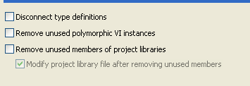

We got same error in similar circumstances (upgraded to LV 8.5 and minor changes to vis). The error also disappears when we select enable debugging, which includes block diagrams in the EXE file.  Our problem is with the executable file size, which is about 40MB when this option is selected. Our application is quite largeand even without the block diagrams the size is about 20Mb which is already large indeed.
Is there any other way to get rid of this error and do not increase the exe file size? What is the reason of the error, in the first place?
Thank you
(3,630 Views)
Hello AOrtin,
Another possible workaround for this issue is to use the additional exclusions section of Application builder.  Uncheck all of the items on this category as shown below.
Also, are you getting the exact same error as described above?  There were two bug fixes in LabVIEW 8.5 for Error 1502 when building EXEs but you mentioned that you are already using LabVIEW 8.5.
