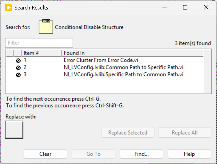

Do you have a Conditional Disable Structure which has a RUN_TIME_ENGINE case that has broken code?

I did find the thread, where someone had this issue. But sadly - I don't use any Conditional Disable Structures
 The only one I found are from NI an can be found in vi.lib (so I can't edit them)
