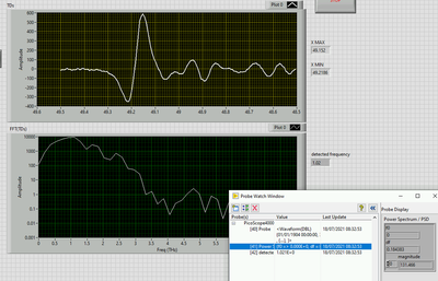

OK, the FFT now works, but only when it's probed?! If I don't probe and just let the vi run to completion, the graph is blank. If I probe these positions:
when the VI comes to completion it then displays the FFT correctly:
What difference does probing make?!

In answer to the question "What difference does probing make?", one that comes to mind is "it slows things down and "messes" with the intrinsic LabVIEW variable called "Time".

Interesting. Actually, it now works whether probed or not, but requires the program to be run at least once beforehand.
