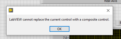

I am trying to use an Express XY Graph in a VI.  The block diagram shows the Build XY Graph block with a "?" in it.  The help says use right-click Replace|all pallets| Select VI.  I did. But I can't find a simple XY Graph VI to put in the placeholder.  Where is it?  Where in the manual does it say what vi's can go in here?  Am I missing something fundamental here?

Sure.  I'm doing Bishop's Modern Control Systems tutorial.  He uses an Express XY Graph VI which looks like
When I place the same VI I get a poor cousin:
The help says to use the rightclick menu "Replace" to find the graph VI that supposed to go where the question mark is.  I can't find that.  If I replace from the Block Diagram I don't see anything that looks like the XY chart.  If I go to Select VI, I get right to the LV library and have no idea where to find the XY chart.  If I try to replace from the panel, and stick in the Express XY Graph, I get another error:

I've never seen Build XY look missing like that.
Since that node is yellow, is it possible someone converted that to a regular subVI, but then failed to attach it?
Have you tried going to the front panel, graph palette, then click Ex XY Graph?

Hi RavensFan,
I see the same problem in my (private) LV2019 installation. (Somehow, somewhere there was a problem at installation time for this very specific ExpressVI. But as I don't use such ExpressVIs I don't miss it.)
Let's see if this problem vanishes once I update to LV2020CE…
@Max:
I didn't bother to correct/repair this problem because there are other ways to build plots for XY graphs. You may try to repair (or uninstall/reinstall) your LabVIEW environment. Or you may try to upgrade to LV2020CE as I will do in the next time…
