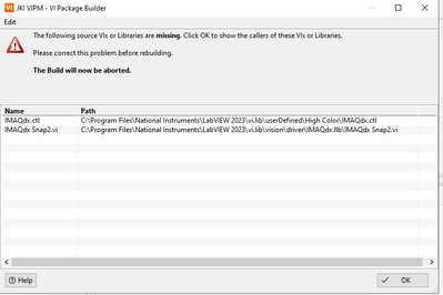

I have some code that does not build using VIPM due to missing dependencies related to IMAQ driver.
The Snap2.vi physically exists in: C:\Program Files\NI\LVAddons\niimaqdx\1\vi.lib\vision\driver\IMAQdx.llb\IMAQdx Snap2.vi
How can I point VIPM to look in the correct folder?
I added the sample data since I don't know if this is LVOOP related.

copy vi.lib from C:\Program Files\NI\LVAddons\niimaqdx\1 to C:\Program Files\National Instruments\LabVIEW 2023
