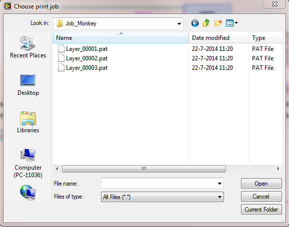

This shouldn't be new, but I couldn't find exactly what I want. I'd like to browse folders (not files!!) on LabVIEW. I've managed to browse files using File Dialog.vi, but is it possible to do the same thing for folders?

Thanks for your fast reply. I already know that feature, but I actually then have to be in the folder, then click "Current Folder".
What I want, is only to click/select the folder and click OK. Something like this:
