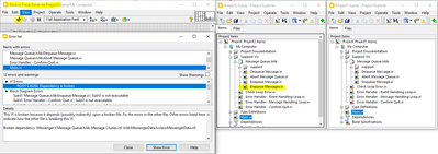

I am using the Message Queue.lvlib from the Create Project->CMH template in two different projects.
This leads to following, quite annoying error regularly.
Broken dependency: Messenger-t'Message Queue.lvlib-Message Cluster.ctl'.lvlib:))Channel.vi
After deleting: "Documents\LabVIEW Data\2023(64-bit)\ExtraVILib\ChannelInstances" the channels get regenerated
and the error often vanishes.
Since I find it really helpful to use the same library in more than one project I wonder how to get rid of these errors regularly.
Any suggestions?

I think this image concludes the issue pretty good. Be aware that those are project structures that are 100% copies of NI's CMH template. I simply added one VI to the second projects Message Queue.lvlib

     I might have a suggestion for why you are having problems using the Create Project>CMH template.  I use the Channel Message Handler in almost all of my "major" LabVIEW Projects, but they are sufficiently different that I've not (yet) run into "name-clashing" issues.
     I recently went to a Local User Group meeting where someone was explaining a (very) large Project that used the QMH template, modified to use LabVIEW Classes for the messages.  I asked why he use LVOOP here, but only for the Message Handler stuff, and he said he did it to gain the feature of "Name-spacing", associating the Classes with the Project.  I recently noticed that the shipping CMH models also are using Classes, so I decided to try it on my current Project (which, so far, has three simultaneous CMH loops, a Stream, and two Tag, all Class-based), and I'm not sure I notice a benefit (other than getting me more familiar with LVOOP).
     The problem, I believe, you are having is that LabVIEW is getting "confused" when trying to work with Message Queue.lvlib.  You have two such libraries, with exactly the same name, stored in the same place.  So when you try to use the "other library with the same name", it looks, says "Oh, the library is already here, I don't need to recreate it", and oops, its "members" are wrong (it does, or doesn't, have "Enqueue Messages").
The solution, I think, is simple.  In your Project, where you define the Messenger Class, give a unique name to the Class.  I also recommend that you open your Project and look at the Dependencies, which should show all of the ChannelInstances .lvlibs at the bottom of the list.  [To see the Dependencies, you might need to click on "Project" at the top of the Project View, and enable "Dependencies" under "Filter View"].
