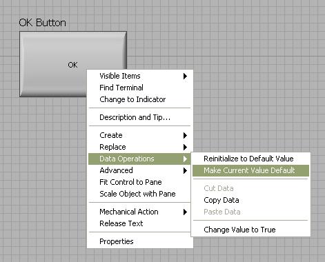

I made a application with some boolean buttons.
No I'm having the following problem:
After I build the project and test it, the buttons are not pushed (False).
That is excactly what I want.
But when I connect it to the PLC, there are some buttons that are pushed (TRUE) automatically.
In my opinion it is very strange that some buttons do that, beceause they al have the same operation: "Switch Until Released".
Do I have to change the operation?
When I have to do this, it is very strange that some buttons work properly, and some buttons not.
I hope someone can help me.
Greets.

You can use a invoke node and select "reinitialize to default".

make sure that all your boolean buttons have the property "Latch when released" (offcourse based on your application)
Or there might be a chance that you have created some locals or property nodes which are wired with a true constant
What does that sentence indicate? I suspect:
- Frontpanelbinding
- Reading shared variables/datasocket and writing data to the buttons (variables/property  node "value")
Without seeing the code, it is impossible to tell what is going on....

Norbert,
There is a variable coupled to the button.
The variable stands in a DB (as boolean ofcourse), and this is coupled in a program.
The variable is just used to reset the variable.
In my opinion the variable is nowhere set to TRUE.
So what can the problem be?

I have NEVER seen buttons to change their value just on their own. This is independend of the setting of the button....
So there has to be some code changing the value of the button.
