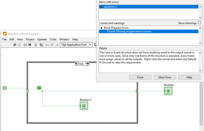

Bool indicator is "True" if I connect this indicator to terminal. (In case structure)
Why he is "True" if constant to case is "False"?

Hi Lugaro,
Because you NEVER set that boolean indicators to FALSE.
Because you also made TRUE the default value of those indicators…
Because indicators, which are connected with the connector pane, should NEVER be placed within (case) structures!
Based on your question: Did you take those "Training resources" offered at the top of the LabVIEW board?

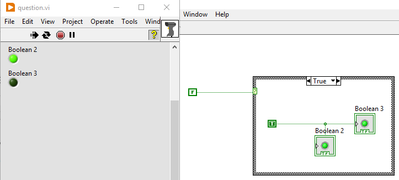

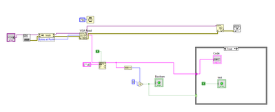

Hello. I repit my simple demo in another file and they show different result. Why?
My original problem is VI for bar-code scaner.
I scan bar-code and wont to see it while I dont use scanner. But string indicator clear in next cycle. Somtime (and today) it work as I wont. Sometime case work evry cycle after start - clear "string" and ON "test" indicator

Thank for "Highlight Execution". But it show that indicator must be "False".

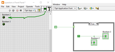

@GerdW wrote:
Hi Lugaro,
Addendum:
Because an indicator, that is connected to the connector pane, is set to its default value at start of the VI execution. That is in contrast to an indicator that is not connected to the connector pane, that will not be changed just by starting the VI.
Regards, Jens
Kudos are welcome...
Message 7 of 12
Message 8 of 12
(527,337 Views)
I repeat my previous reply:
Addendum:
Solution: Make sure, that a return value is always set at the end of the VI execution regardless of case-structures, ....
i.e. in case that "Boolean 2" is your return value, set it outside of the case structure:
Regards, Jens
