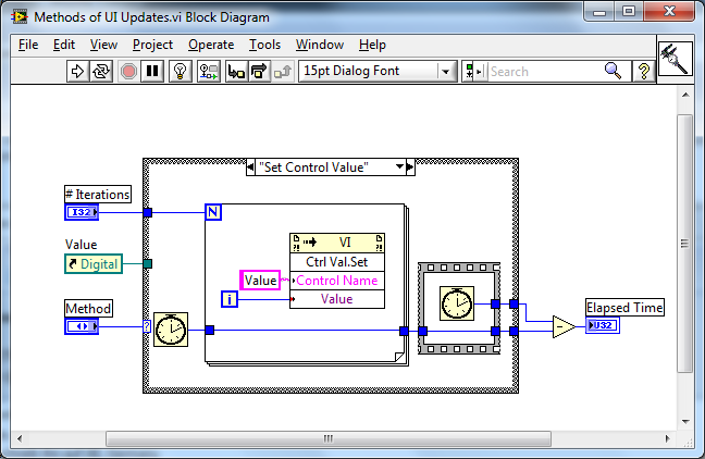

Ben,
on my machine (Dell Latitude E6500) running Windows 7 and LV 2010f2, the property node value is about fourty times slower than using the VI Server method "Set Control Value". But there are not many controls on the panel though....
I do not know if the method gets slower in relation to the number of controls on the panel. This might reduce the difference, nevertheless i would think that "Set Control Value" is always faster than the prop node....
Norbert
The code above is about 40 times faster than this one below (beware: DEPENDENT ON MACHINE!):
Norbert
