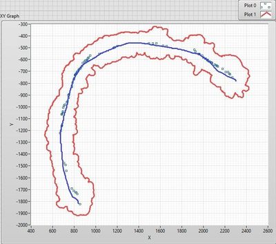

I need to develop a program to find the middle line for variety image contours (different shapes). I have already found a way to extract the middle line by using the distance transform, skeleton and some other morphology algorithms:
Now, My problem is curve fitting. After applying B-spline algorithm, I obtained the following result:

You may find the vi and data set files in the attachments.
After sorting the data, the outcome result is:

I'm pretty sure that the problem is that the spline fit needs to get the points to fit in order, but when you say you "sorted the points" what you are actually saying is that you sorted them by one of their coordinate values... NOT the order the points should appear in.
If your data looks somewhat circular all the time, you could try something like this instead:
1. Start by doing a circle fit.  LabVIEW doesn't have one, but it has a sphere fit which works as a circle fit if you just use zero for all of the Z values.
2. Take the center of that circle.  From there, calculate the angle to each point.
3. Sort the points by that angle.
4. Pass the points using that sorting to the spline algorithm.
If your data doesn't always look circular you might have to get more creative with the sorting, but you need to put them in actual order, not just sort by one column of values and disregard the order of the other column.

Well the best I can think of is one where you start at one end somehow, then move to the point that's closest to that, and so on.  I don't know how you could reliably choose a good starting point for an arbitrary share though, and also it take a long time to run that algorithm if you add a lot of points (proportional to the square of the number of points).
