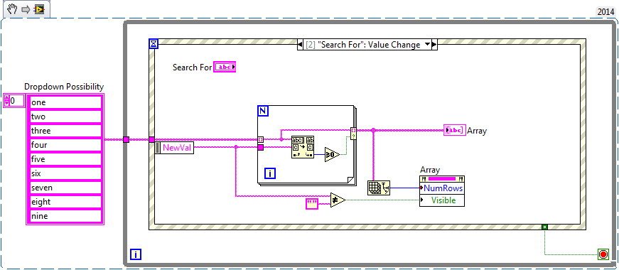

Here's what I need.  As the user types, a drop down list (from my ARRAY) is narrowed as they type.
The combobox is almost there...however, the combobox only works on the first match (doesn't show other matches), and it doesn't have a drop down, it does have pull down.

You can try something like this:

Thank you  gregoryj!
This will work!  Much better than anything else I've seen.  All I need to do is grab the "value" of the "Array" to extract the choice.  It's missing an autocomplete tab function, but, I'll settle for an addtional user mouse click.

Glad to help,
I did forget the mouse click selection, this might do the trick:

Or just update the box where you were already typing 🙂

Many Thanks gregoryj !
Brilliant!
