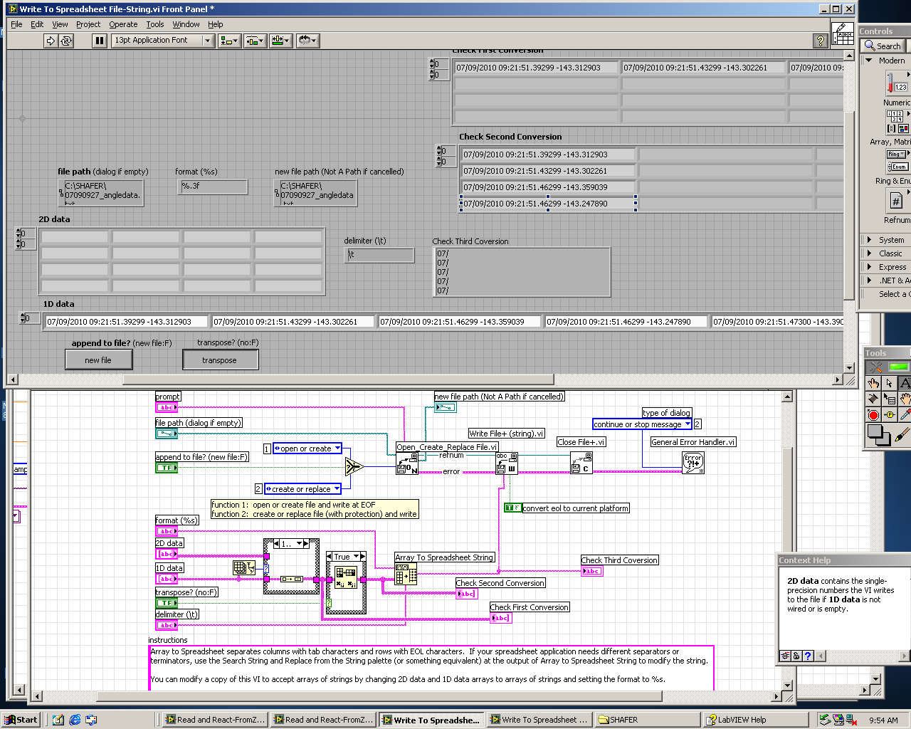

Here is the screenshot. The GUI is in the upper portion of the screen so you can see what the outputs are.18477iE318314CDAD3B4FF Thanks.

I'm still having an issue. I am thinking it might be in the way I am building my array that I pass to the Write to Spreadsheet VI. Here is a screen shot of the code that builds the array.
18485i9F76DAE34F53384C

You are building a string not an array. You need to replace the concatinate string with a buil array and get a 2D array not a string for this to work properly.
18487iAC66B1AB8EE3A4E2

It is almost working now. I get both the time and the data, but the problem is that the Array to Spreadsheet String function is only letting through three characters from each column.
