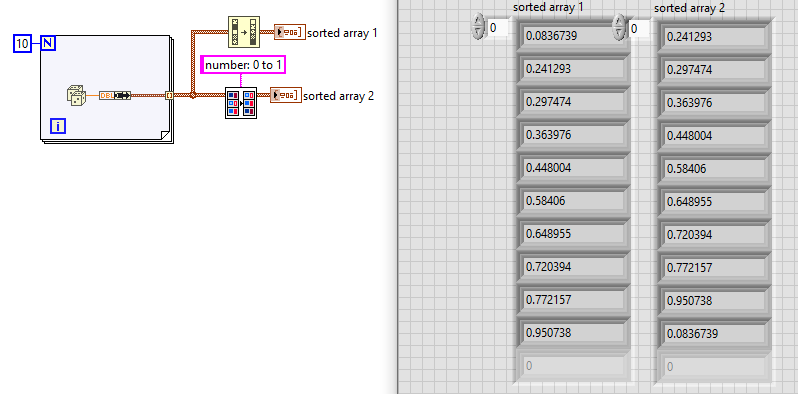

OK. Done benchmarking.
Your VI doesn't give the same results for floats as the Sort 1D Array for 1 element clusters:
Message 19 of 21
(2,111 Views)
Probably hard to fix that.  It's getting the value from the variant as a string, then trying to use those values for an alphanumerical sort, but it won't work properly for numbers in exponential notation (which is how it sees DBLs under the hood).
Message 20 of 21
