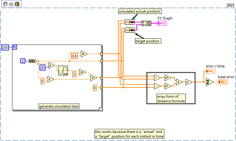

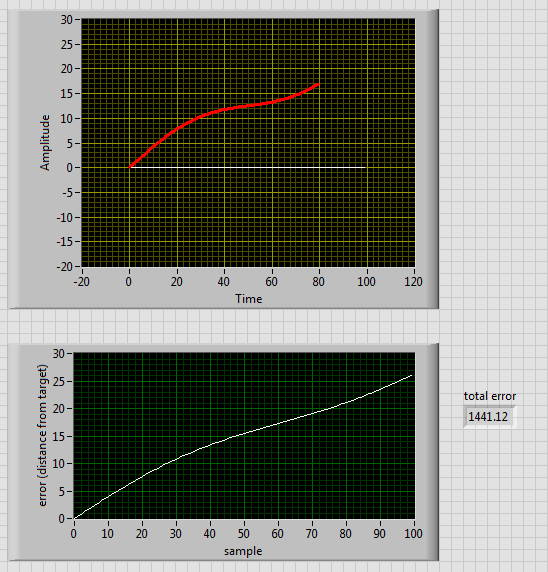

I agree with Bob  -- an accelerometer is probably the wrong tool to measure position.   Be that as it may, even if you had perfect position data you still face the problem of quantifying the error relative to the ideal trajectory.
In my post I was suggesting comparing the position data at discrete points in time to get the 2D distance between them, not operating on the acceleration.
