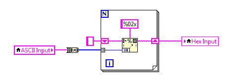

The one you saying right now is any number or string convert to octal, somewhat like this.Capture.PNG
But i need now is to convert Octal to ASCII. It's different.

How about changing the format string from your %02x to %03o? That is exactly what pincpanter was saying. If that is not what you want to do, show us some code of what you want to achieve, rather than what you do not want.

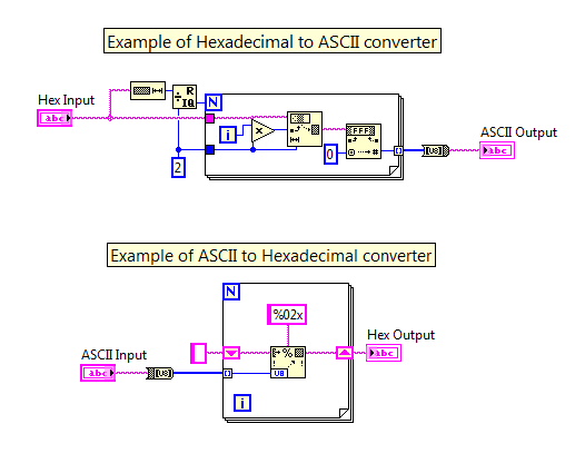

Just do what pincpanter and rolfk say and replace the FF / hex functions you have with the ones rolf showed you. It's a direct swap!

So what's wrong with the inverse functions from my post? The Octal String to Number function is right besides the Hexadecimal you show in your example.
Also note that part of the confusion is likely in your use of what represents the ASCII side. Many people consider the ASCII part the human readable text side, while the hex/octal/decimal number side is the machine representation.
Rolf Kalbermatter  My Blog

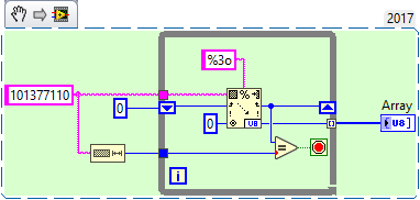

So you have an input ASCII string containing (3-digit?) numbers in octal format and need to scan it to U8 values.
The code is much the same you posted for hexadecimal format, but using Octal String to Number instead of Hex String to Number. Probably extracting 3 characters at a time.
You may also use Scan from String with %3o format, see just as an example this code:
Paolo
