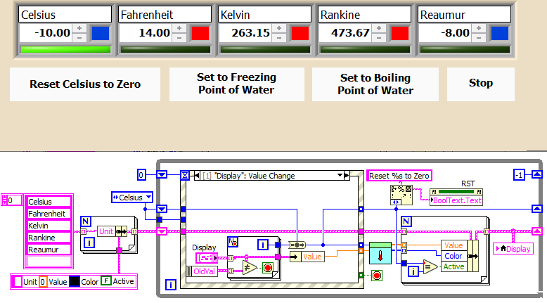

Here's a quick draft (did not implement the text color and mouse enter, etc. Cluster and array containers could be made transparent. The unit labels could be centered. I did not bother with cosmetics).
(One property node for the boolean text and one local variable to update the control cluster. Zero value properties instead of dozens! Three event cases instead of eight! Note that the cluster only has the numeric enabled. The rest are disabled and act as indicators). See if this can give you some ideas at simplifications.

GerdW and Altenbach,
Thank you so much for replying to my post.  There's so much I don't know about LabVIEW and it definitely showed in how you improved my code.  I especially like Altenbach's solution.  Very elegant.  The use of an array of clusters and enums simplifies it quite a bit.  One local variable and no property nodes makes it easier to follow.  With the use of an array of clusters I think all the text colors have to be the same.  I can't change them individually.  Is that true?

Yes, array elements share all properties except value. As I said, for a colorbox the color IS the value, so you could make the numeric background transparent and place the colorbox behind. Now you can have at least different background colors for each element. Here' show it could look like (rough draft)
