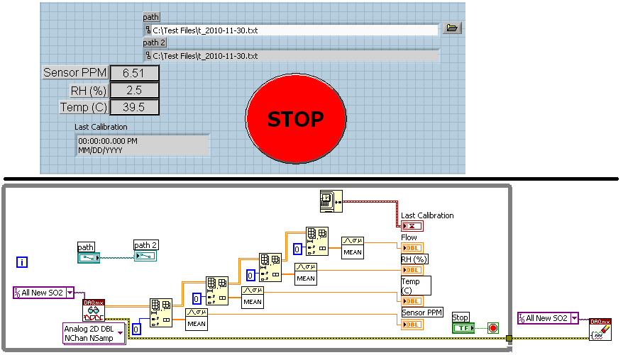

I cut EVERYTHING out of the program to see what the cause is or what potential workaround there is. Here is a screen capture of the front panel and block diagram.
It is very clear that there is a connection between the DAQmx read and the delay of the path control dialog. I cannot think of any reason that the DAQmx read would only effect the path control dialog.

Well, that code is quite a dog (see also), but what exactly is the loop rate of the while loop?
I don't understand what you are saying. Does the loop rate slow down when the path control is in the loop?

I think what he is referring to is that the loop may be executing very fast and slowing down everything. Try putting a 50mS delay in the loop and see what happens.

That's the thing, I'd expect the loop to be slowing everything down, but it does not seem to be the case. I may just not be noticing it, but the rest of the program seems to work in a timely manner with the exception of the path control dialog. The front panel updates with new values, the rest of the computers functions seem to be in working order as well. Any ideas why the only part of the computer affected is the path control dialog?
I did insert a small delay into the loop and that has fixed the problem.
I appreciate your help altenbach and SteveChandler!
