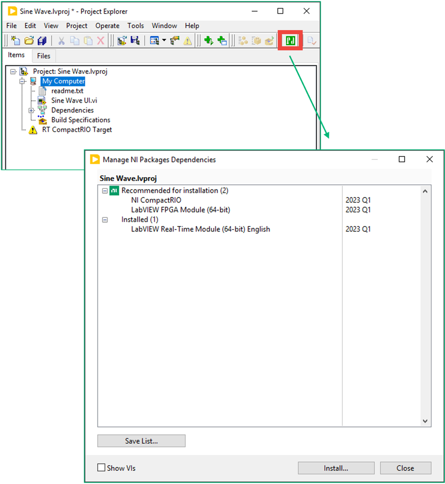

  • LabVIEW Introduces a Tool to Identify and Install NI Drivers for a Project
    • LabVIEW 2023 Q1 includes a utility to assist you in identifying and installing NI drivers used by a LabVIEW project.
      • Select Project>Package Dependencies from the Project Explorer menu or click the Package Dependencies button in the Project Explorer toolbar to open the Manage NI Package Dependencies dialog. The dialog examines the project to discover which NI packages are used. You can click the Save List button to save a text file that lists the identified packages.
    • If one or more packages are not currently installed, the Install button will be enabled. You can click the Install button to launch NI Package Manager, and install the required packages.
      • Note: Building the list of packages to show in NI Package Manager may take several minutes.
    • Enable the Show VIs checkbox to understand the reason a package is listed as a dependency. This shows the VIs referenced by the project that the tool assumes are provided by the package.
      • Note: This tool might not correctly identify all the NI packages used by a project. The tool uses information from directories where NI installers install files. However, a LabVIEW project might reference files in a directory that is shared by multiple installers or the tool might be missing information for some installers.
    • Each time the dialog box opens, the tool attempts to update a component from ni.com to get the most-up-to-date directory information.
    • If the project uses an FPGA target, the dialog will identify LabVIEW FPGA Module as a dependency. However, the tool is currently unable to recommend a specific driver for the target. If the FPGA Module is installed, FPGA targets in the project will show their model numbers, and you can search for applicable drivers on ni.com.

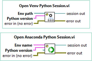

  • Python Support
    • LabVIEW 2023 Q1 adds support for Python 3.10. In addition, LabVIEW 2023 Q1 supports Anaconda and venv virtual environments with the new Open Virtual Environment Session function.
