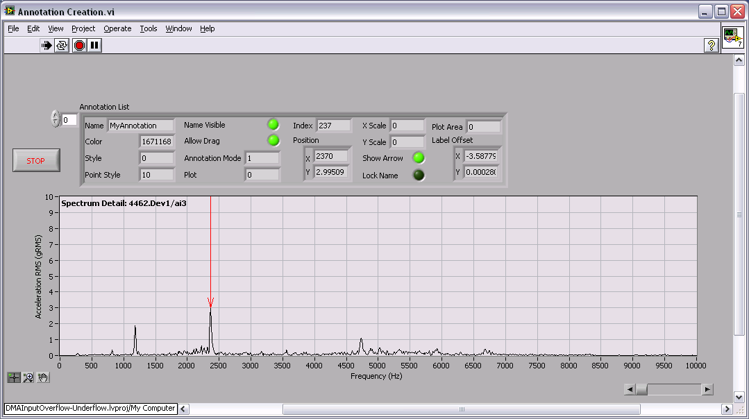

Can someone please explain the Label Offset property of the Annotation List (or Cursor List)? I can't figure out what the offset is relative to, or how it's magnitude seems to change with the location of the annotation. There is obviously something I am not grokking about it. A negative Y Offset can result in a label above the annotation point, and the same offset values will change the distance of the label from the annotation point depending on the placement of the point on a plot.

Here is a simple program that displays a graph, and allows you to create annotations by right-clicking on it. The built-in function is superceded by my simplified create annotation vi with tries to create an annotation that is located where you clicked (anyone else tired of having to hunt down annotations placed randomly--typically off screen..) and with some defaults (snap to plot, color = red...). I discovered that when set to snap to plot, it doesn't seem to matter what I put in for position or offset, it just does what it wants. I should point out that the graph has a multiplier of 22+ applied to the y scale. This vi was created in LV8.5.
What you'll find is that if you create annotations on peaks, the labels will be off the graph display. If you create an annotation at a trough, the label will be visible. It seems to me that somehow the y-axis scale is not properly being accounted for, and since it ignores what I tell it, it's hard to account for.

Huh. When you created the annotations, did you right-click on the peak so that it popped in right there, or did you have to move the annotations after the fact? This is a bit of a mystery for me.. still, what is the significance of the Label Offset #s. In the screenshot you posted, the first annotation has a Label Offset of -2.24646.. in the y direction. Granted, the "..E-21" or whatever maybe cut off from display in the indicator, but even so, Cursor1 is clearly located above, not below, the annotation coordinate. I'm hard coding the offsets to 0,0 when the annotation is created, and that is obviously not being used.
Also, I'm running mine in XP. Here's what it looks like on my machine.

Ok, I finally figured out how to control where the annotations labels are placed. I am pretty sure this is a bug, because it makes no sense.
I think it should be safe to assume that the annotation label offsets are with respect to the location of the annotation point. Sadly, this is not the case, except in the trivial situation where the scale multipliers are 1 and the offsets are 0.
Here is a example vi which demonstrates how to place customized annotations that are snapped to a plot at the location clicked when you right-click to select "Create Annotation". There is a subvi called Create Annotation that does the work, and is suitable for inclusion in other apps. An image of the block diagram is shown below.
For those that are curious, here are the equations that determine the location of the origin that the annotation labels are relative to:
Actual Offset Origin = scaledPosition * scaleMultiplier + scaleOffset
Origin Offset = ((scaledPosition -scaleOffset)/scaleMultiplier) - scaledPosition
where scaledPosition is the x or y position as seen in the annotation list element (this is in scaled axis units)
and Origin Offset is the offset from the actual origin required to place the label at the location of the annotation cursor (i.e., where you'd expect the origin to be)
You can see that for both of these equations, the trivial case (0 offset and 1 multiplier) produces the expected output:
Actual Offset Origin = scaledPosition * (1) + 0 = scaledPosition
Origin Offset = ((scaledPosition - (0))/1) - scaledPosition = 0
The vi's are saved in 8.5. I expect this bug to be fixed at some point, at which time my vi will really munge up the placement of annotation labels. Be WARNED.
