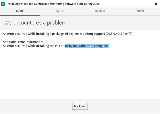

An error occured while installing a package: ni-skyline-rabbitmq-suport(19.6.0.49152-0+f0)
Installing NXG Items in for 64bit LabVIEW
After looking into the error in the event log.  I found I had locked down the system and had WORKSTATION was DISABLED.
RabbitMQ service could not START because it depends on WORKSTATION.
